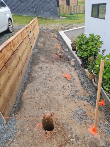

Hi all
I am looking to build a garden bed in this section between a wooden retaining wall and a stone retaining wall.
My plan is to concrete in stumps at the orange crosses under my string line and the secure some treated sleepers to those concreted stump posts.
Ill dig small channels up the hill to ensure the sleepers go deep in the soil at the top of the slope.
I will put in a drain at the lowest point that feeds into the ag drain behind the stone wall and cover with gravel and landscape mesh and then fill in the garden bed with soil. The soil will ideally be level at just below the lowest point of the wooden retaining wall.
Is there anything i should be careful of during this project?
