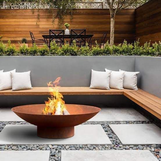

I am trying to make something like the attached
photo. box with seater
