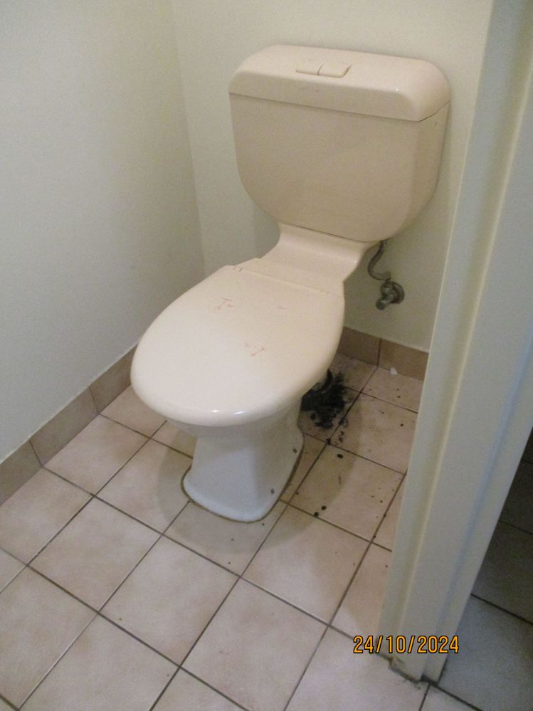

Hi all. Am thinking of replacing tired old toilet. On inspection, looks like toilet is cemented down, and copper waste pipe is coming up through floor. Copper waste pipe is 145mm.

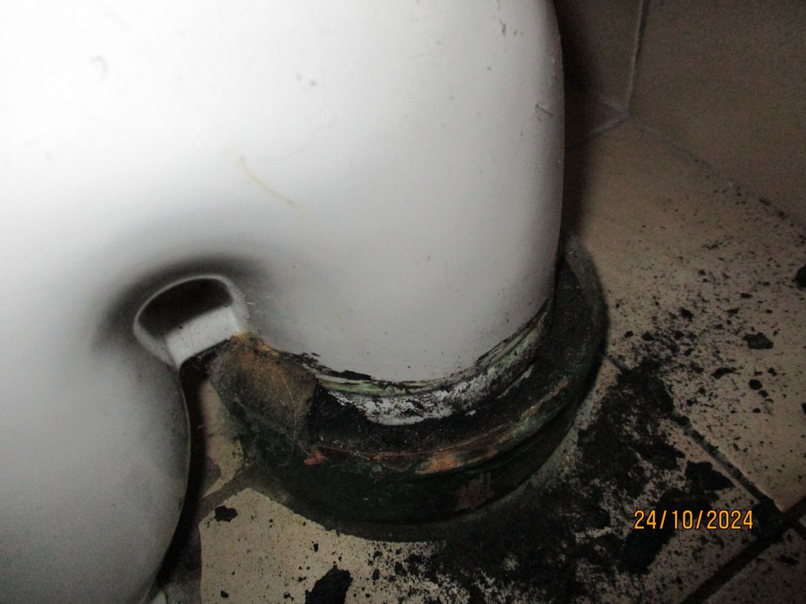

There are various models available at the store, but the basic points I've mentioned should be sufficient to guide your decision-making. Regarding a possible repair, your toilet has been sealed with a type of bitumen sealer, which I believe has reached the end of its service life. I recommend looking at Fluidmaster Universal Wax Pan Seal as a possible replacement for the old seal. Would it be possible for you to please take a photo of the entire toilet including the cistern and cistern tap? This will give our members a better idea of its layout. We can then make recommendations on possible replacement units.

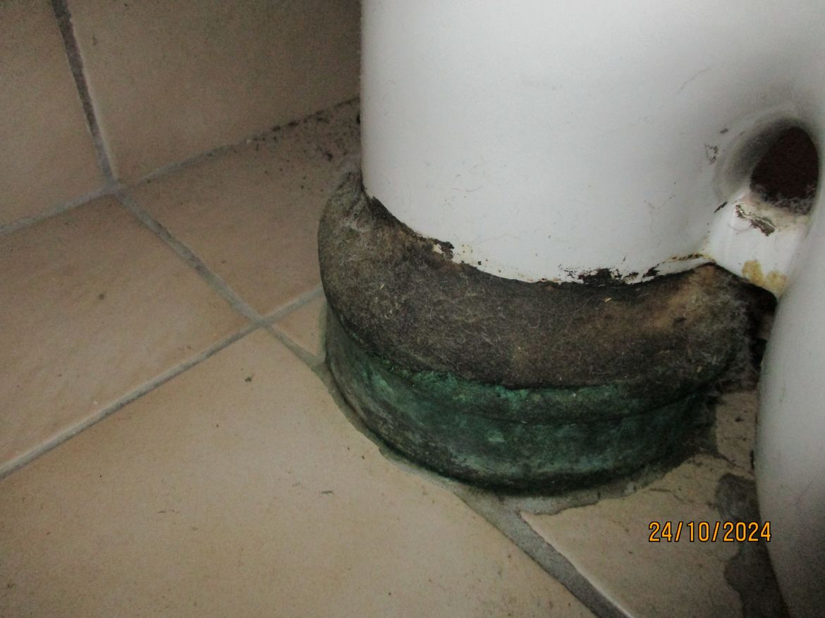

The current Set-out from the wall is 150mm. The diameter of the copper waste pipe is 145mm.
I have done some research, but have not been able to see any situations where there was a copper waste pipe protruding above ground level.
Nearly all applications I have seen have had circular Flanges with hold down bolts that fix down the basin to the floor.

Just a friendly reminder that all plumbing work must be carried out by a licensed plumber for safety and compliance.
