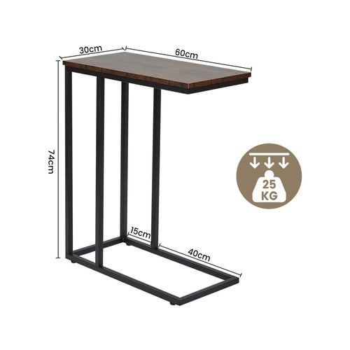

recently purchased this Viviendo side table https://www.bunnings.com.au/viviendo-industrial-style-c-shaped-side-table-bedside-table_p0418108?gad_source=1&gclid=EAIaIQobChMIldOIqJaoiQMVuKRmAh0vNhHVEAQYASABEgKOhvD_BwE&gclsrc=aw.ds
I over looked the height measurements, I dont fancy my chances at a refund, so the only other option is to alter it. It is way too high for my use. My sofa it too low, I wanted to use it to put my computer on, but at its current height it would be up near my chin when I am seated on the sofa.
My question is how to I shorten the legs so it is still balanced, also in each leg is the little duvalacky that the screws go into, so I would have to put them in the newly cut legs..
I need help please any advice would be appreciated.

I imagine that as you are reducing the height of the legs the centre of gravity will be lowered so its ability to support weight shouldn't be reduced assuming you make a clean, square cut across each metal leg that ensures the tabletop sits flat.
If the "duvalacky", which I'm assuming is some kind of threaded insert that accepts a screw, can be removed from the end of the legs, you might be able to simply cut the legs with a hacksaw then reinstall it and screw everything back together. Some testing may be needed to see if this is possible before committing to this plan.
If you were going to cut the legs, I'd suggest using a square such as this Craftright 300mm Combination Square to ensure your cut is nice and square.
Unfortunately, I can't guarantee this will work, but it is worth a shot if you can't return it and are unhappy with the height.
