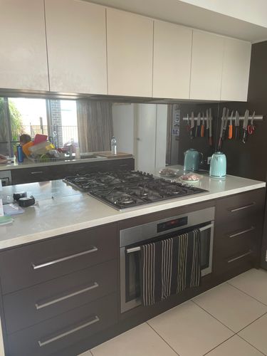

Hi All,
I’m wanting to change the look of my kitchen colours to white. My kitchen cupboards are melamine. Is this possible & what do I need to buy?
