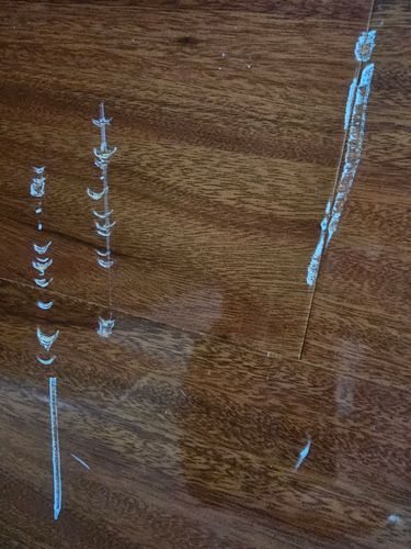

Hi @Dorin88,
Have you tried gently cleaning the area to see if any of the blue markings can be removed from the surface?
To repair scratches on laminated parquetry, start by cleaning the scratched area thoroughly to remove any dust or debris. One effective solution for filling in minor scratches and scuffs is to use Waxstix or wood repair crayons. These can be found in a variety of colours, allowing you to blend shades together to replicate the natural timber grain of your parquetry.
To apply, choose Waxstix colours that closely match your floor and gently fill the scratch, using a cloth to smooth the surface and remove excess wax. For deeper scratches, you may need to apply a few layers to build up the repair. Mixing and layering colours helps create a more natural look that blends seamlessly with the surrounding wood grain. After filling, buff the area lightly with a soft cloth to restore shine and help the wax set. This technique is a simple yet effective way to make scratches on laminated parquetry far less noticeable.
I think the key to success here will be trying to remove the blue marks as they really highlight the area.

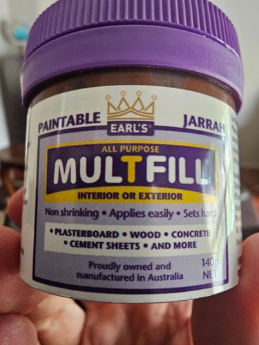

Is this product good for repairing or filling scratches on the parquetry?
Hi @Dorin88
That multi filler is pretty much for deeper cracks and will set hard and will need sanding and sanding ontop of you floor might do wider further damage.
using @MitchellMc suggestion of the colored wax will very nearly hide the scratches once the blue is cleaned of too and no sanding just cloth rubbing.
See @MitchellMc suggestion
Well I went to bunnings and I wanted to buy the waxstix and the didn't have the right colour I was after!
I agree with @Jewelleryrescue, the MulTfill is made for deep cracks and dries hard which means that it has no flexibility in it. The Waxstix on the other hand is more forgiving and is capable of spreading over shallow surface damage.
