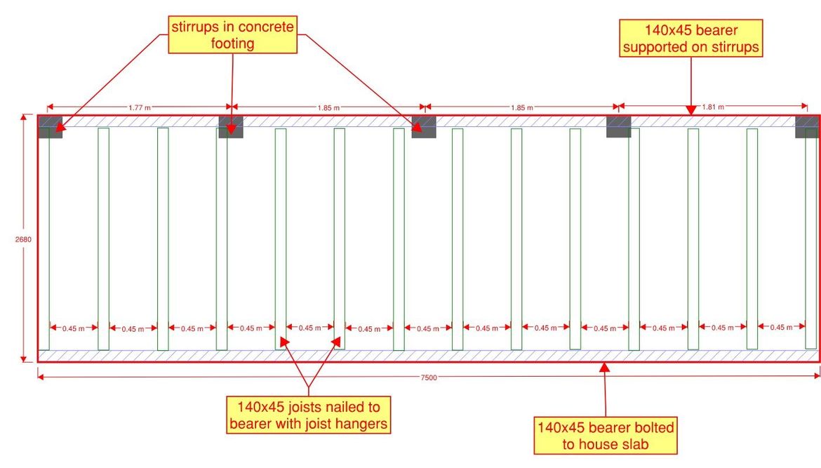

I'm looking to build a new low level deck in our backyard.
I've been looking through the bearer and joist spacing requirements as per this guide (Availability of F7 Pine, Treated and Untreated) and have come up with the layout below. Just looking for some advice if the spacing are okay or if I need to be more conservative? Will I need a bearer in the center to support the load or can I get away with a 2.68m bearer span?
