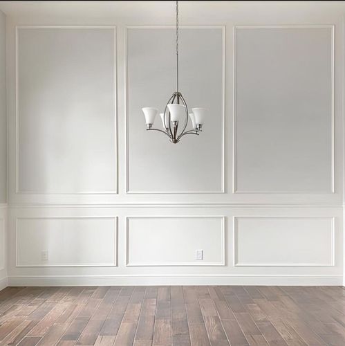

Need easy instructions on how to create such a feature wall with minimum tools.

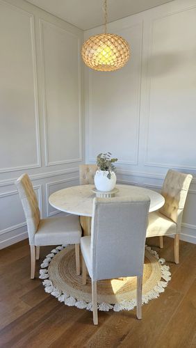

Thank you for all the help. We've successfully completed the project.
Nice work @Nuzuma!
It exudes elegance and charm like it was plucked straight from a cozy corner of a French cafe.
