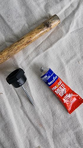

Materials
Philmac Thread Pipe Cap
Saxon Plastic Leaf Rake
selleys fix & go muliti grip
Zenith 10 - 8 x 75mm Galvanised Timber Screw
Tools

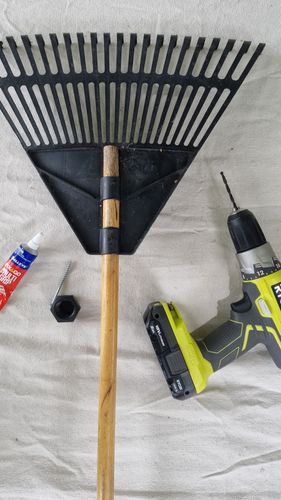

Ryobi 18V ONE+ Drill Driver
Scissors
Steps
Step 1

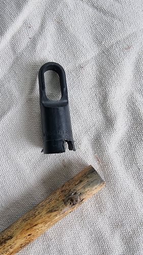

Remove the current end off your Rake with scissors or pliers.
Step 2

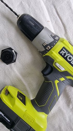

Drill a hole in the pipe cap
Step 3
Thread the screw through the pipe cap, and use the multi grip glue to glue it to the end of your rake.

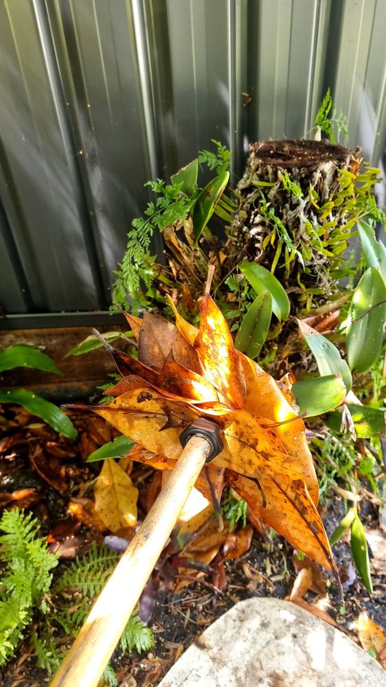

Step 4

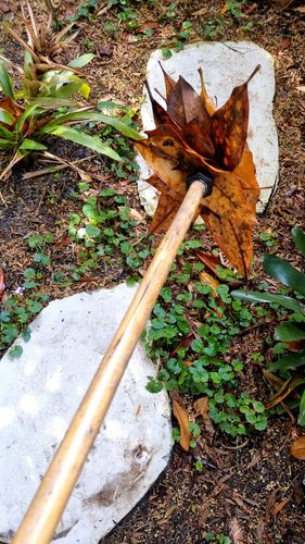

Leave it to dry for an hour pr so before using, and then you are ready to pick up your leaf litter or trash.
Step 5
Easy to place it in your green waste bin without bending.
