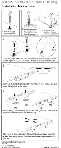

I’m having the same issue. It’s a Caroma opal II soft close toilet suite.
any ideas how to remove the lid off those hinges?

I found this on the caroma website for the opal II, hope it helps.
Marty

Have you had any success so far? The Opal II Single Flap Seat Instructions that Marty has linked to will hopefully help.
