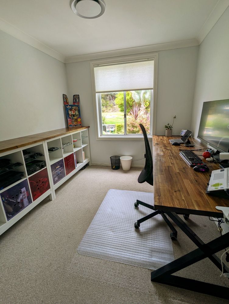

Before
After
Step 5
for the bench side, I used 2 x white Kallax cube shelves with risers and then finished the top with the same specrite wood as the desk side with the same clear cabothane finish.
