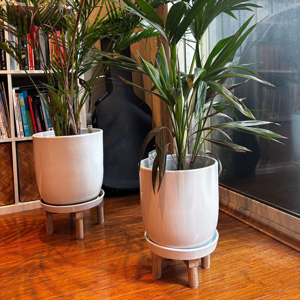

I needed to make something to lift two plant pots off a floating timber panel floorboard in one hour flat, so I used some offcuts from a previous project to make two charming little stands, inspired by Danish midcentury-modern design.

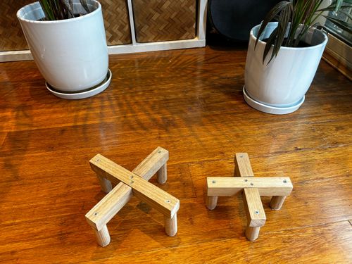

I measured the diameter of the bottom of each plant pot, and subtracted a couple of centimetres from that number to get the length of the cross pieces I needed.
I cut the two pairs of 32mm x 32mm timber pieces from the offcuts, and then used the mitre saw and chisel to make mortise and tenon joints.

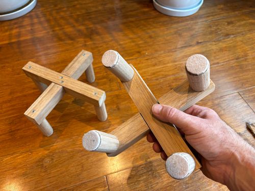

Step 3
I used two self-tapping screws and wood glue to secure the mortise and tenon joints, and then cut and attached four legs for each cross-piece from the Tasmanian oak dowel.
One plant pot was smaller than the other, so I reduced the length of the legs (from 8cm to 6cm) to keep it in proportion.
This photo shows how the screws secure the mortise and tenon joints and legs
Step 4
The final step was to secure these little adhesive felt feet to the legs, to protect the floor.
Don't forget to protect your floor, with these adhesive felt thingies
