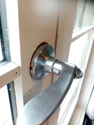

Hi. I have a French door handle but can't seem to take collar off to tighten it. Is there a wee trick with this one please?
Hi @Davereside01,
The hole you can see in your first image is the key to your problem.
If you stick a thin object in this hole, there should be a release mechanism that when pressed will allow you to remove the handle and then the cover plate.
Let me know how you go, happy to help further if required.
