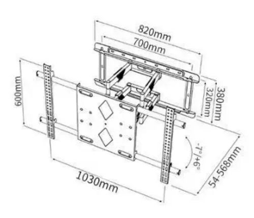

Hi all, I am seeking advices for mounting my 85 inch (46kg) TV with mount (15kg) to a plaster over brick wall. According to builder, bricks are 90mm wide with 10mm plasterboard and 5mm adhesive (dot and dab method). I have done some research and found "Corefix 100mm tv wall fixing with Reinforced Steel Core" specially design for plasterboard over blockwork, are there anything similar that I can use? The closest i can find is ramset ramplug. but without the reinforces steel core to prevent shear force acting on the screw.
So, are 10 of Ramset 100mm Ultra-Long Hex Anchor RamPlug, 4 top,4 bottom, and 2 side of the mount sufficient?
