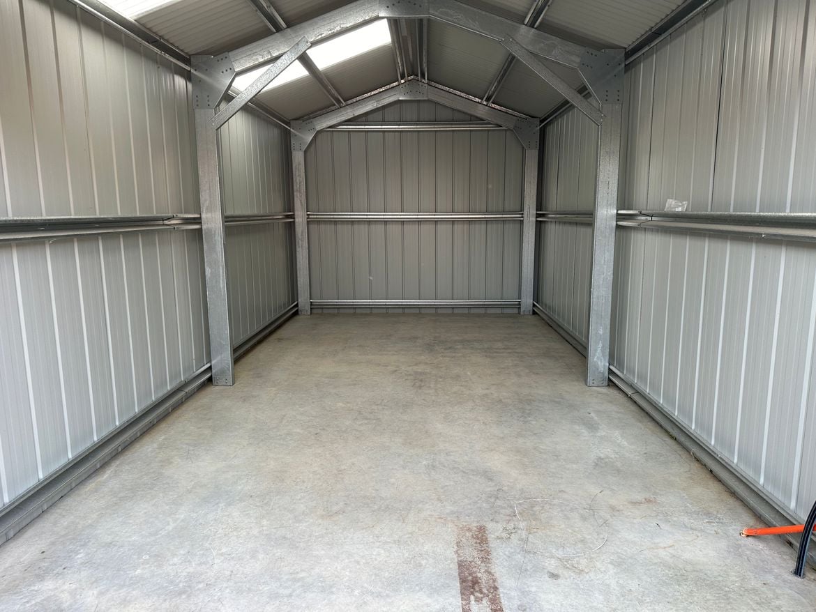

Looking to insulate and line my shed which I want to convert into a mancave. I've been exploring whether or not I would benefit installing a Steel Stud & Track Wall over a traditional Timber frame. I'm planning on lining it with high density Gyprock (13mm) or even fibre cement sheeting.
I've been exploring the Rondo design manuals on how to go about this. I'd prefer to keep the wall as close to the colorbond wall sheets to maximise space in the shed, but this is posing a problem. Initially, I received advice that this could be done by securing the base track to the concrete slab and attaching the header track to the beams at the top. But this would be considered an "External" wall and as such, would require 1.15 BMT gauge. I've had this quoted and it's come out much more expensive than first thought.
I could reduce this cost by going down to 0.75BMT, but the wall would need to what's considered an "internal" wall. I would not be able to attach anything to the wall beam / columns. I'd need to attach the header track to the Truss / Rafter. My shed is constructed as a Portal frame and the truss/rafter is connected to the columns with a knee brace / haunch brace/cleat. If I was to move the walls in toward the centre of the shed and clear the columns, I could make the attachment at the top no issues. But I'd be sacrificing a fair bit of space to do that.
