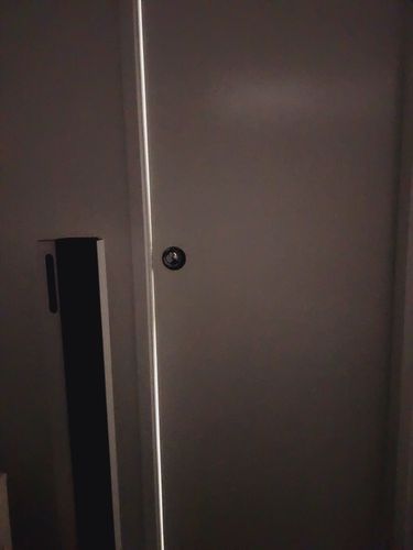

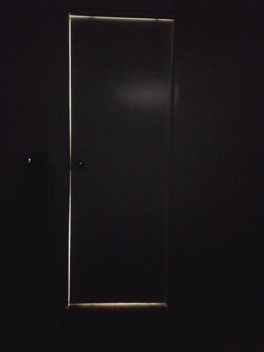

We have three cavity doors in our new house. One thing I don't like about them is the draughts and gaps around them to the door jambs. May I please request some suggestions how to seal these draughts. Pictures attached.

On the latch side and the top of the door, your best option is to attach timbers such as this 42 x 18mm Pine FJ Primed DAR using brad nails. Having one on each side of the door gives a channel for the door to run in and a pocket for it to close against.
For the bottom of the door, it is not as easy as you don't want to attach something that will become a trip hazard. My suggestion is to use a draught stopper which can be moved and put in place when you have the door closed to reduce the draught under the door.
Thanks Jacob for your advise, considering I am just newbie and don't have a nail gun 😀 do you think this draught seals would work ? https://www.bunnings.com.au/syneco-9-x-5-5mm-x-5m-d-type-door-seal_p4062594?store=8066&gad_source=1&gclid=Cj0KCQiA6Ou5BhCrARIsAPoTxrD9p2R-S4X7q25fouyF-8FkmQtj54H_fSnYEXUZEKf5jyZ_-bkAHb8aAoUOEALw_wcB&gclsrc=aw.ds
It would work on the face of the door that closes against the jamb, but it will not work on the top of the door. It's worth noting that it may affect the door's ability to latch as it will change how far from the jamb the door will sit when closed.
If you were fine with just closing the gap on the left and using a draught stopper on the floor, then this is certainly an option.
