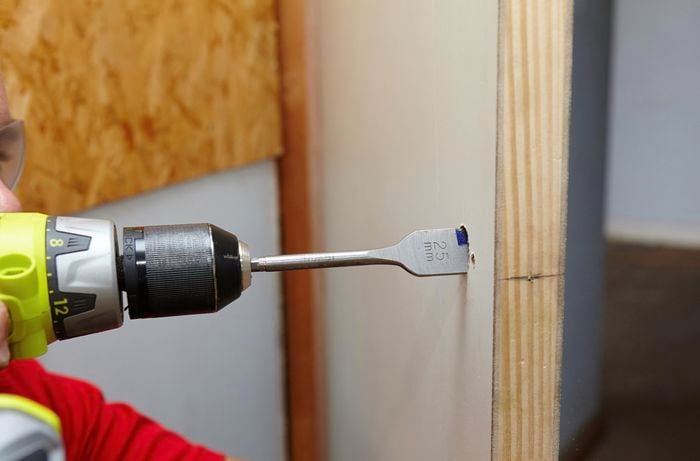

Increasing the diameter of this hole can be a bit tricky because the two tools that are usually used to do this, a spade bit or a hole saw, require material in the centre to get the hole started and guide the outer diameter of the bit.
This can be mitigated by clamping a piece of plywood such as this 897 x 600mm 7mm Plywood to the door, marking out your holes as you would normally and drilling through the plywood and then halfway through the door before doing the same on the opposite side of the door.
