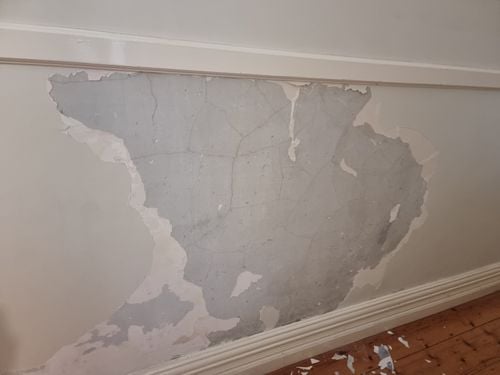

Im painting the hallway of a 100+ year brick cottage.
I've gone to chip off flakey paint and it's come off in large shards. It appears to be several layers of paint together and well over a meter.
What's exposed now Looks like concrete.
My goal is to repaint the room. I've got dulux 1 step primer and wash and wear.
However somethings telling me that spakfilla isn't right for an area this big. how to seal/smooth/otherwise prep this to paint?
