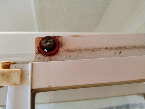

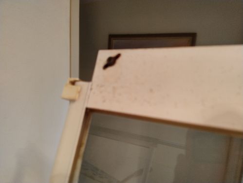

Welcome to the Bunnings Workshop community. It's sensational to have you join us, and thanks for sharing your question about your shower door wheel.
I suggest removing the wheel from your shower door and bringing it with you to the store. The odds are very high that you'll find a compatible wheel in either the Cowdroy or Rolltrak sets. The wheel is sometimes kept in place with a locking nut behind the wheel itself. You'll need to use a shifter and some WD40 to loosen the nut.
Please remember to wear personal protection such as gloves and goggles when working on your repairs. Please take extreme care when working around your glass shower door, an untimely hit or extreme application of force could shatter the glass and cause injury.
