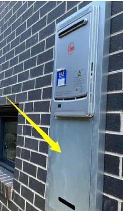

Do i need to get the Hotwater system box to be painted. its recessed in the external wall as below.
its newly build home.
Hello @Samara1
There is no need to paint the housing of the gas hot water heater. Quite often it is either galvanized or powder coated and carries with it a guarantee on how long it's supposed to last out in the elements. You can check your warranty paperwork to get the details on the hot water system housing.
