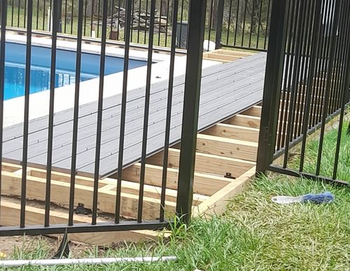

I have completed my deck frame & started laying composite boards and just realised a 1500mm section & a 1170mm section of outside h3 frame will be touching soil when backfilled. It works out the top of the frame will be level with the ground outside of the fence.
Will it be alright as 1 side is touching ground?
Could I add some h4 against the h3 as a barrier from direct contact to soil?
Looking forward to your opinion.
