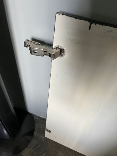

the door just came loose and I couldn’t “put it back” to the hole.

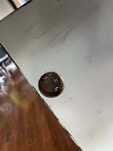

You might have to unscrew the other part and then put it in the door, rotate to lock it in place and then screw it back?
Hi @helenaz,
I'm fairly confident that what @J-P has said is correct.
You can see that the hooks inside the rebate line up with the notches in the hinge. I suspect they will lock together to hold the hinge in place.
Let me know how you go and if you need further assistance, please don't hesitate to ask.
Yes I have managed to follow the instructions just simply used a screw. And they are back to where they were now. Big thanks to the workshop.
