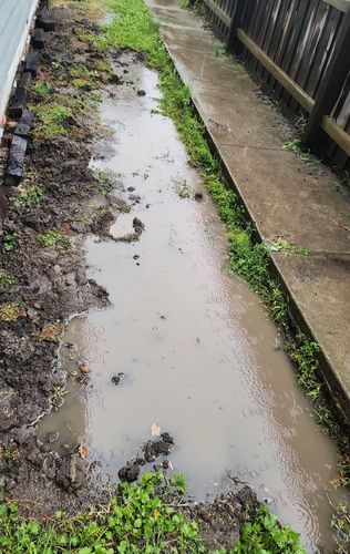

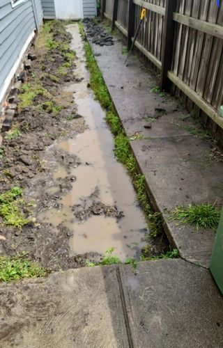

I have a drainage issue on the side of my house which is causing issues when it rains heavily as the water just pools and has no where to go. Unfortunately the only stormwater points are under a driveway and are unlikely to work due to the levels of the property in this part of the house.
Option 1: using geofabric, scoria and the megaflo to create a French drain to drain out into the backyard into a soak well https://www.bunnings.com.au/reln-soakwell-rapid-flow_p4770021
After which I would put soil and grass on top.
Option 2: Same as above but instead of draining out to the backyard, connecting the megaflo to the bottom of a silt pit lifted up to the concrete level in the lowest corner then allowing the megaflo pipe to fill up and peculate out (hopefully evenly underground). Unsure if this will work but it will allow me an access point to pump water out in the event of very heavy rains.
Option 3: take much more soil out, sloping the ground away from the house backfilling with scoria, geofabric on top of the rocks then soil/grass on top. However don't think this would be ideal in case of very, very heavy rains.
Any thoughts / ideas?
