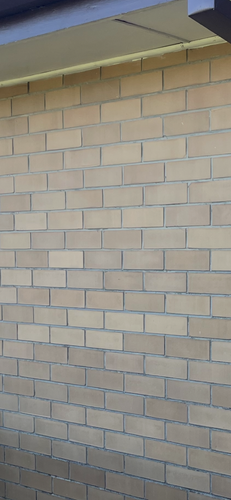

Hi - I’m looking to change the look of the entire exterior of my house, it is a brick veneer with these light orange/cream colored bricks. They’re probably very familiar - they have quite a smooth finish and are not particularly porous (water doesn’t soak right in rather beads off the surface).

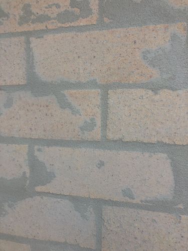

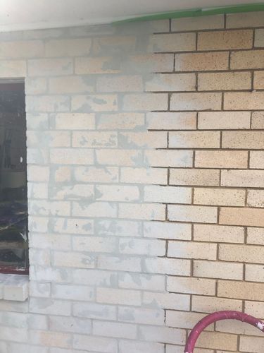

My current plan is to spread Dunlop Acrylic Render using gloves hand/sponge etc to create a light bagged look - that is I want to fill the mortar lines pretty well flush with the brick face but I want to leave the smooth surface of the brick face in tact (in a trial run basically this leaves the bricks looking fully coated but only the mortar lines really have the render in them, the surface looks sort of painted by the color of the render but doesn’t have any texture/sand of the render itself). Other than pressure washing the brick and removing effervescence with vinegar and letting it dry well, I don’t plan to apply anything else to the surface and would spread the render directly onto the brick.
My current plan is then to paint over this lightly bagged brick with a few coats of an exterior paint such as Taubman’s All Weather. It is self priming so I wouldn’t intend to apply any other primer or sealer over the light render coat, I’d just paint right on top of it.
