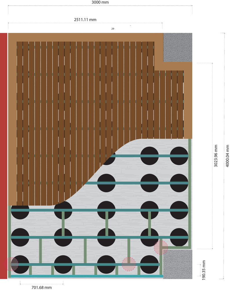

I'm closing in on trying my hand at a small alfresco deck.
The deck is over a concrete slab and will eventually 'L' around the house, extended along the top edge. So I am mindful of the distance for the top row of blocks and have pushed them as close to the current top edge as possible. (same distance as indicated by bottom row 190mm over hang)
Height to be under approx.1800mm to top of boards (merbau 18mm) - and TuffBlocks seem appropriate for footings. - I just don't want to see the blocks poking out underneath. (50mm Blocks + 90mm Joists + 18mm boards + 5mm for Klevaklips (?) and joist rubber etc)
90x45 treated pine (M something approriate) for joists and "bearers", although the bearers aren't actually bearing any load.
I am unsure of:
1. whether or not to pin the bearer to the house, as doing so appears make it difficult to drive batton screws into the noggins which wrap the pillars.
2. if the bearers - the boards running parallel to the house should be doubled up 90x90
3. or if I actually even need the bearers at all - I'm mindful of ventilation
4. if joist hangers are needed - perhaps for bearing the nnoggins? red circled areas etc concern me..
I am considering fewer tuffblocks between the central joists - increasing the span to around 900mm as I feel as though Im over engineering a fairly small alfrescco deck.
notes: boards are spaced 5mm (ventilation) apart and framed with140mm merbau.
