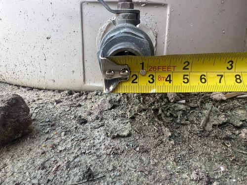

I would like help understanding what pipes and fittings I need to connect a new ozito water pump (800W constant pressure) to existing rain water tank with this outlet (pictured)

Hi @jaycollison ,
I believe this product might help you with the fittings.
Blue line pipe to run between tank and pump. Don't forget to put a ball valve in there so you can turn the water off.
cheers
Marty
Hello @jaycollison
Thanks for sharing your question about connecting your Ozito pump to your rainwater tank. For ease of installation, I suggest looking at the Ozito 9 Piece Tank To Pump Installation Kit. This kit has the necessary parts for you to easily link to your water tank. The only other part you need to purchase is a standard garden tap.
Here is the link to the installation instructions: Tank to pump installation kit.
However, if you are looking to install your pump further away from the tank, I suggest using blue line pipe in combination with Philmac fittings. The common size used is 25mm, but you might need to reduce to 20mm in some applications.
Hello @Marty_greenshed
Thanks for sharing your knowledge and experience in regards to the installation of the water pump. I totally agree that using blue line pipe is an excellent way to link your water pump to your rain tank.
