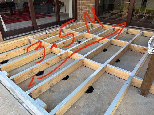

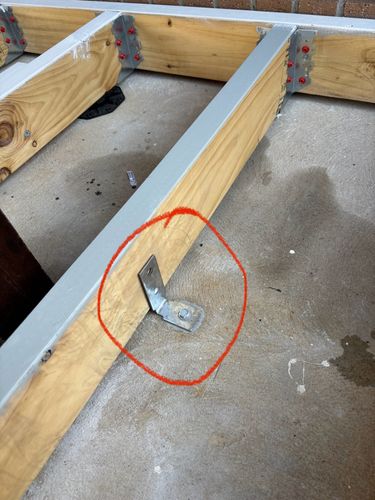

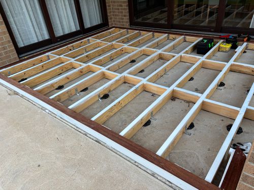

I have so far built a 5 x 3.5 meter merbau decking frame. The joist you see are spanned 3.5 meter and holding with joist hanger at both end plus 2 decking joist mini feet in between under the joist and concrete. My question is how many concrete bolts should I put per joist? My joist are 140x45 H3 MGP10.
