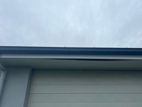

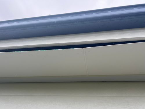

hi,
how do I fix this? There doesn’t appear to be water damage to the board.
Welcome to the Bunnings Workshop community @Cassidy1. It's a pleasure to have you join us, and many thanks for your question about eave sheets.It looks like your eave lining boards are not properly fixed to the roof timbers. To fix this, you will need to locate the roof timbers (rafters or beams) and secure the eave lining boards by screwing or nailing through the sheets into the timbers. This will hold the boards in position and prevent them from hanging down. Make sure to use appropriate screws or nails to ensure the boards are securely attached.
Since you'll likely be working on a ladder, check out this helpful guide: How to use ladders safely.Please let me know if you have any questions.Mitchell
