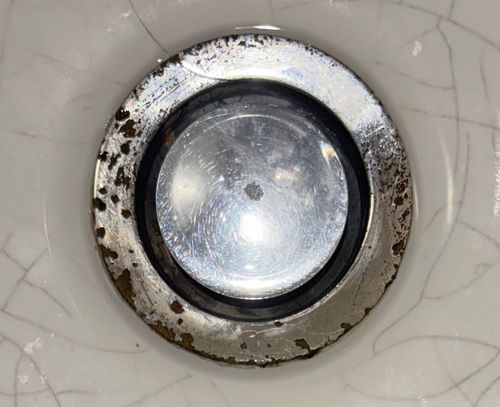

The drain in my bathroom sink basin is corroded due to bleach. Can I repaint the chrome myself or do I need to replace the drain?

Welcome to the Bunnings Workshop community @Thania. It's terrific to have you join us, and many thanks for your question about basin drains.Unfortunately, I don’t know of any chrome paints suitable for use in a sink, as they would likely not hold up well to water and use.
However, you can address the issue by sanding back the compromised chrome and then using a more durable option like Rust-Oleum Tub and Tile Touch-Up Kit. This product is designed for areas like sinks and tubs and will give you a more long-lasting finish.
Replacing the waste is another option, and it might be a simpler solution, but it will require a plumber to install the new drain correctly.Please let me know if you have any questions.Mitchell
