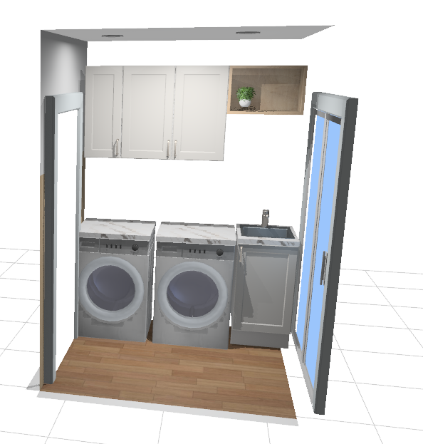

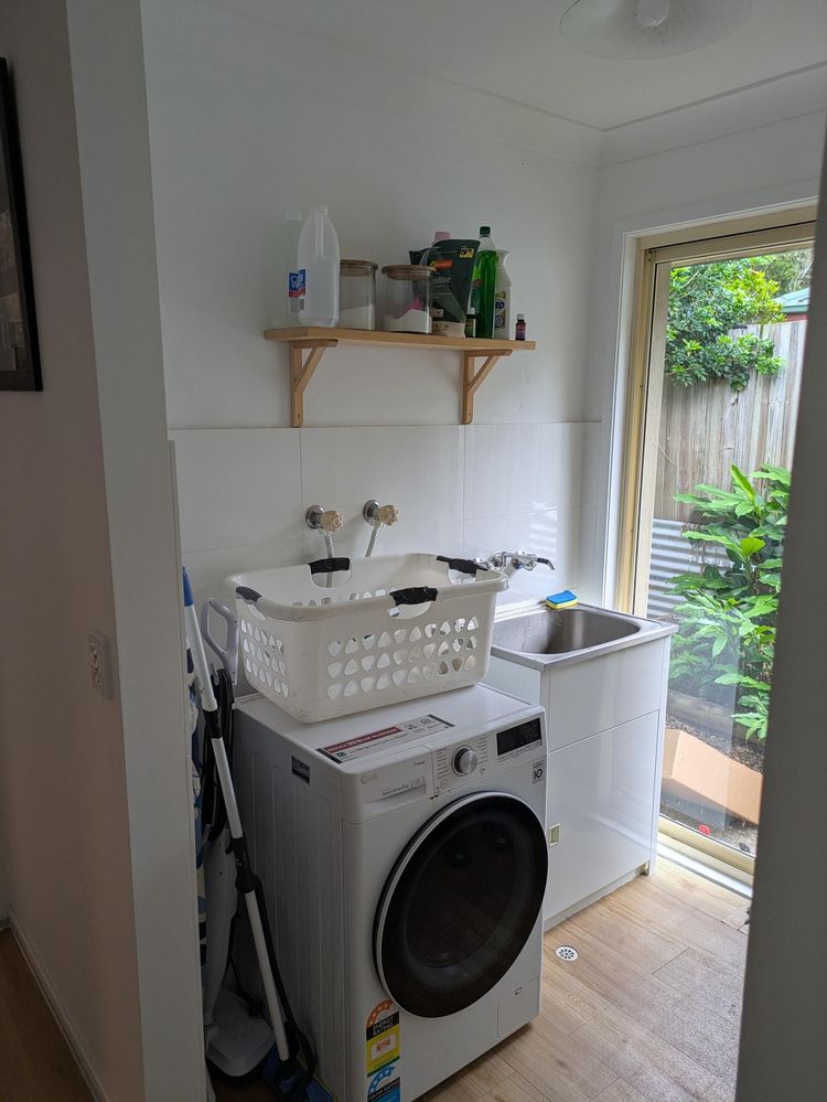

We are wanting to DIY this laundry and have a Kaboodle Laundry all planned out. However we have some questions on timing and how to get started if you can please help (existing laundry and plans below):
- What would the timing of the DIY install look like? Is it:
- Remove shelves and washer from laundry
- Plumber to disconnect current plumbing
- Remove trough from laundry
- Electrician to change power point location
- Install cabinetry
- Install benchtop
- Plumber replumbs laundry- connects sink
- Splashback to be tiled
- Move appliances back in

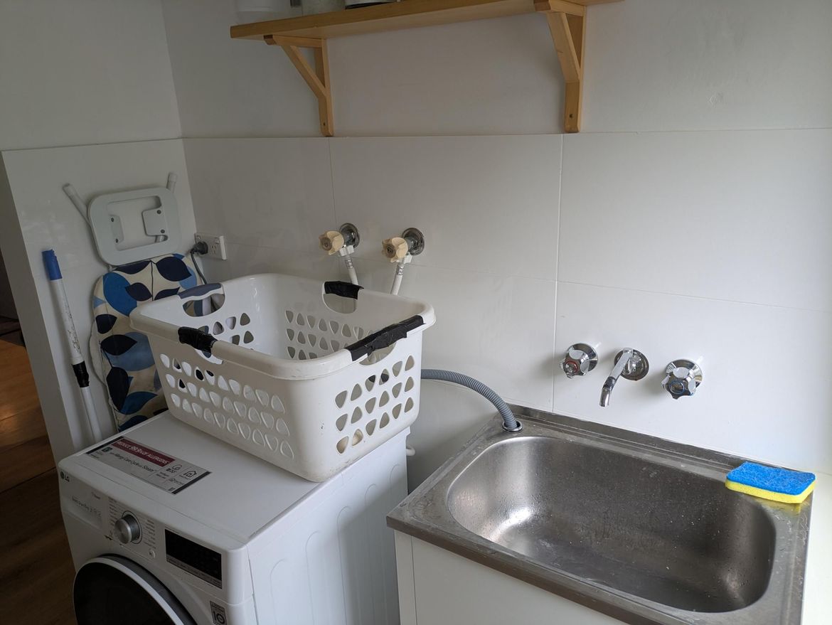

- We have tile running down most of the wall, however as the plumbing will be moved to below the bench, we were wondering:
- if all the tile needs to be removed?
- do we just remove the tile above the bench height so it can be re-tiled above?
- Would we be better off leaving all existing tiling and putting some vinyl tiles over the top to keep the waterproofing intact?
- I've read waterproofing only needs to be up to 150mm- so if we left the bottom layer of tiles would that be sufficient?
