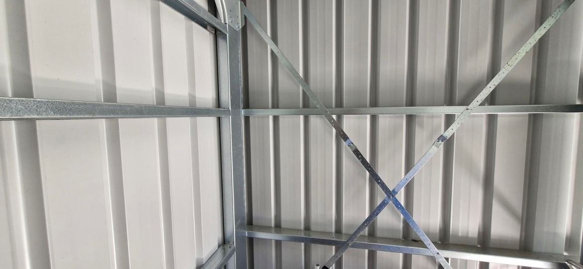

The shed:
- Metal frame, metal sheet shed. Almost white sheets - quite heat reflective.
- Concrete floor - will likely have rubber mat put over the top.
- Located Adelaide Hills, SA - can be quite damp in winter.
- Use; Solar equipment and Generator room - significant heat and sound produced internally.
- Will be Air Conditioned, mainly for temperature regulation in Summer and humidity control in winter (pending available excess winter power).
- Ventilation and what type TBC
- Wall girts at 75mm thick, with fluted (superdeck) sheets externally.
- Ceiling insulation is half complete using foil backed glass insulation (space blanket) between the roof sheets and the purlins.
- In hindsight I should have fitted a vapour control barrier to between the wall sheets and the wall girts.
- All air gaps, holes etc are sealed up.

- Removing wall sheets to add sarking / vapour control - two walls are sandwiched in place.
- Building an internal wall frame to support insulation. I only have the width of the wall girts to play with - 75mm plus a little more with the sheeting.
