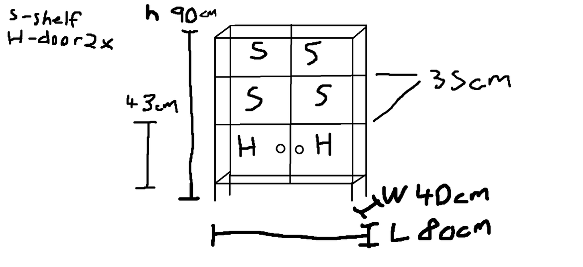

Want like to make custom for my gaming setup.S for my PS2, PS4, (Wii and Mini Nintendo will fit in 1)H for my game, controller, and much more
Oak Wood
I will need to provide painting to white.

I've done a preliminary drawing of your cabinet and have based the material on 16mm MDF for ease of sourcing and assembly. Can you please double check the height of the last space at the top. The internal space of the bottom is 430mm, the middle is 350mm and the space left is 56mm is this correct? If not, please let me know and I will modify the image.
Hello EricL, 56mm should be around 65mm and want like to add middle for wood.
extra with 4 door for bottom with handle. cheers
Thank you for that extra information regarding your cabinet. As soon as I finish the drawing, I'll post it here.
waiting for the cabinet photo.
also, i like to know the price of those build. cheers

My apologies for the late reply. I've placed the rest of your diagram below, please have a look and tell me what you think. In regards to the price of the materials, it all depends on what panel you are using. For example, if you were to use Specrite 1800 x 405 x 18mm Timber Multi Use Pine Panel it would be much more stable than MDF.
But the advantage of the MDF is that you can build the entire cabinet with just one panel of 2400x1200. I propose visiting the store so that you can see the type of material you'll want to use. Both of these timber materials must be primed before being painted.
Please note that these measurements are based on the ones that you have provided, please double check them before committing to cut your timber.
for the bottom one i like to add a leg. i think top one have to be 35cm as well.i will check measure for ps5 hopefully can fit in there.yes will go to bunnings to see. does Timber Multi Use Pine Panel worth it.

and can you show me your drawing of cabinet final build.
I've placed the sketch of your cabinet below. The measurements are for reference only, please double check the sizes before you cut the panel. Each CUSTOMwood 2400 x 1200 x 16mm Raw Standard E0 MDF is currently priced at $42 dollars. I suggest using Zenith 8G x 40mm Countersunk Rib Head Chipboard Screws - 28 Pack to screw the panels together. Please make sure to drill pilot holes to prevent splitting the wood.
