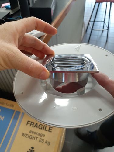

When I'm ready to start tiling, how do I attach the shower grate to the puddle flange? Do I pack around it with tiling cement? Thankyou
Hello @Alita
Welcome to the Bunnings Workshop community. It's sensational to have you join us, and thanks for sharing your question about your shower grate.
Using tiling cement is what some trades use when it's a brand-new shower area. My best advice is to make sure that the grate is properly supported with adhesive underneath to make sure that it does not sink when stepped on.
