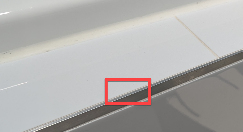

Hi @Dave-1 ,
Here it is:
Probably more a small chip than a dent, but it's annoying that when one enters the bathroom, the skylight in the bathroom hits the spot and highlights it (shiny) to make it more obvious.

Thats going to be a little difficult to repair, its such a fine point right on the edge... Mmmmm maybe a gentle sand with some emery paper over the end of a 20mm wide piece of timber (think toungue depressor with a strip of sandpaper/emery paper) But go very slow and gently so not to make it stand out more, all you are after is removing that shine as trying to remove the dint might be a lot more effort.
I would sand the way you would use a **** file. Diagonally and run along the edge. trying to keep the tongue depressor flat/level. You will end up with fin scratches I expect so if thats unacceptable I would wait until we have some other ideas 🙂
Personally I think anything you do to cover a very tiny dent is potentially going to be more of an eye-sore. Regardless of how well you paint that aluminium strip, it will wear off. Not to mention spoil the look of the clean trim line. I would use a metal nail file on the fine side and just give it a very light touch up. Or place tape over it and give it a light tap with a hammer and small punch to knock it back in.
It's one of those things that you notice it now, but over a small period of time it will be forgotten about. I am very fussy on things like this. It's taken a very long time to learn that lesson. I have 3 tiny dents in my fridge that I have no idea where they came from. They stuck out for weeks, now they virtually don't exist.
