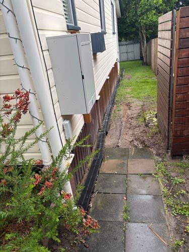

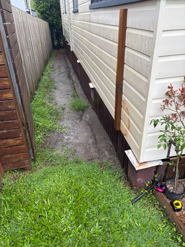

We are looking to do some drainage down the sides of our house.
We are looking to lay ag pipe at a depth of 300mm down the side of the house, with a stormwater drain at both ends to a depth of 300mm.
My question is whether digging down 300-400mm right next to concrete house stumps will compromise the integrity of the stump?
If it’s not okay, how would we lay drainage for this type of house to catch rainwater from the down pipe?
Photos are of existing drainage set up (or lack of).
