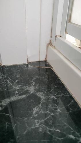

Hi! I'm wondering what the best option is to seal/ fix this crack in my bathroom tile? It's right next to the shower so I want to ensure water doesn't get into the crack. Not looking to replace the whole tile. Thanks
Hi @BigBuilder,
Thank you for your question.
I'd suggest using Knead It Aqua Epoxy Putty. Knead it into a thin sausage and press it into the crack.
Once dry, you can lightly sand it to make it smooth like the surrounding tile.
You can then use a small craft paintbrush to paint the putty to match its surroundings.
