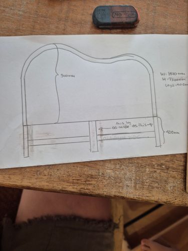

My plan is to create something like this drawing. My plan is: base, foam + fabric and then some sort of legs. ( Or I might leave the legs out and do the board on the way to the floor, I haven't decided it yet. )

Having the curved top adds a fair bit of complexity to the project, but it is still manageable.
Unfortunately, due to the size of the headboard, there are no sheet products you could use to simply cut the shape out, attach foam and fabric and then use it as a headboard. You are going to have to create a frame then attach multiple pieces to the frame.
I'd also advise against having the legs like in your example as it will weaken the structure without really adding to the look.
You'll need to start by building a timber frame up to about 100mm below the lowest point of the curves.
You'll then use the MDF or plywood sheets to form the curve. You'll need two sheets with the exact same curve. Mark the curve and then cut it with a jigsaw. Once cut, trace the curve onto another sheet and cut it out so you have two pieces with the exact same curve.
You will then attach these MDF or plywood curves to the frame with screws so that they extend up above the frame by 100mm at the lowest point of the curve.
Once the curves are in place, screw a series of blocks between the sheets along the full extent of the curves.
These blocks will give strength to the curve and allow you to attach a thin strip of 3mm MDF along the edge of the bedhead to close in the shape. 3mm MDF is flexible, but this may need to be done in sections so that it doesn't snap under the pressure.
Once the shape is made, you can attach your foam and fabric and you will have a beautiful, strong, custom bedhead.
