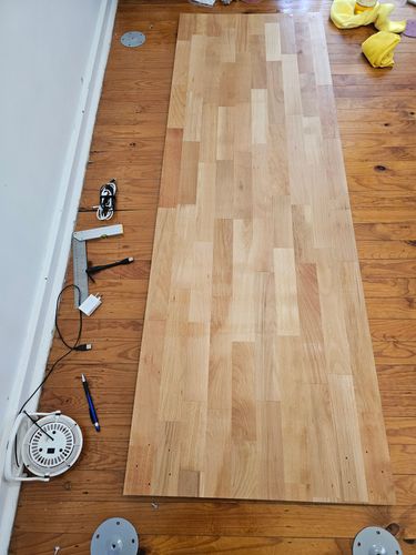

Awesome, thanks so much! I ended up going with your recommendation of the oil application and it's awesome!
One question I had while applying it. Should I apply the oil horizontally (longest side end to end) or vertically (shortest side end to end).
Here is my progress so far!
Nice choice.
You can apply the oil in any direction just enough for it to soak in.
I like to polish off the remaining excess using a circular motion like buffing a car.
I then use a fresh final cloth like microfibre for the final polish.
It is quite a process I must say. I have to wait 24hrs between coats and the manufacturer recommended 3-4 coats. I am not diluting it either.
I might just do 2 coats at the bottom, and 3-4 on the top and sides.
Reason why i went oil is that i can use this on chopping boards too!
It won't make a massive difference, but oiling in the direction of the grain is generally recommended. This would mean applying it vertically, running from the bottom of your image to the top.
Don't forget to post an update once it's finished. I'd love to see how it looks when you're done.
