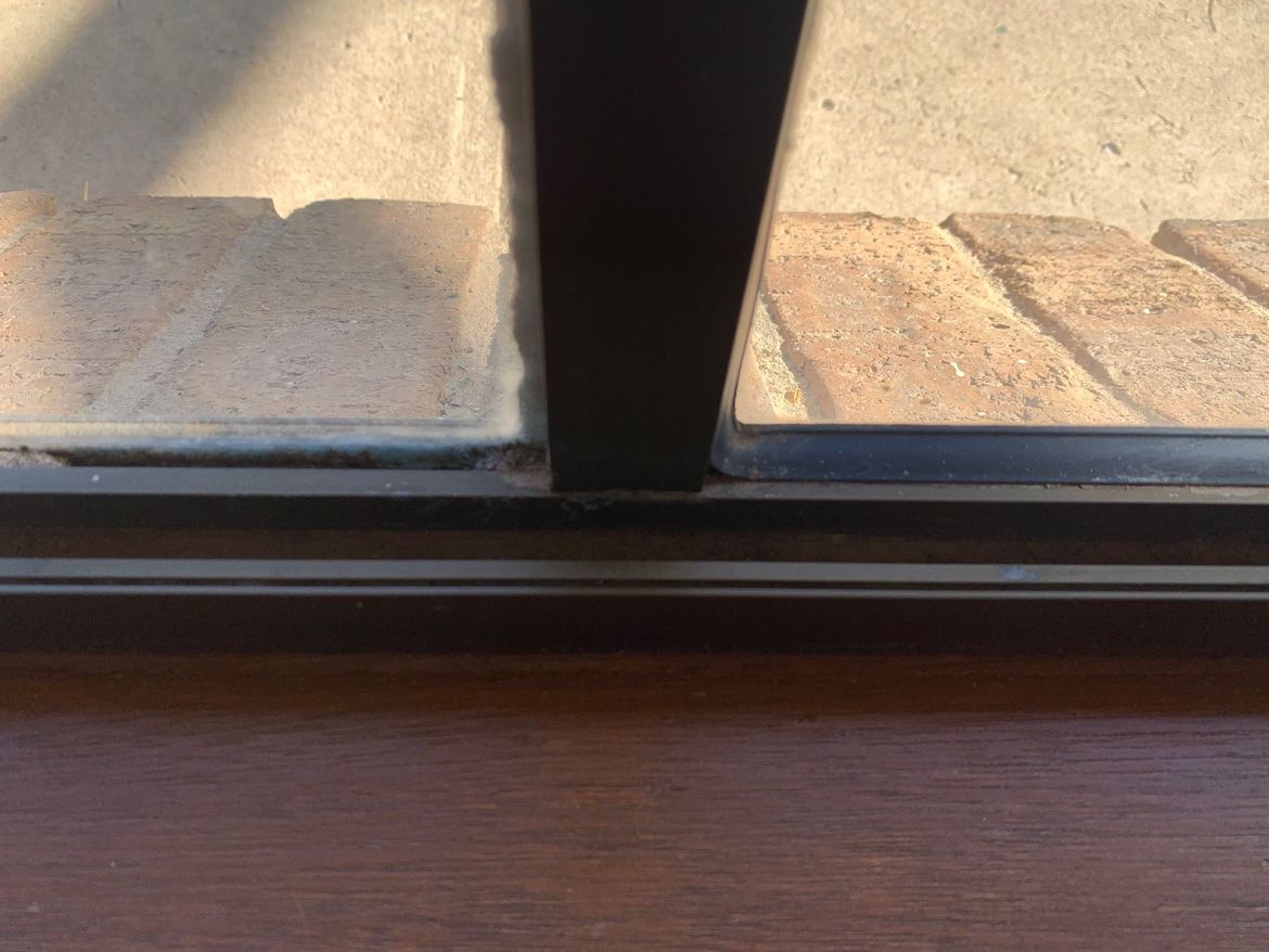

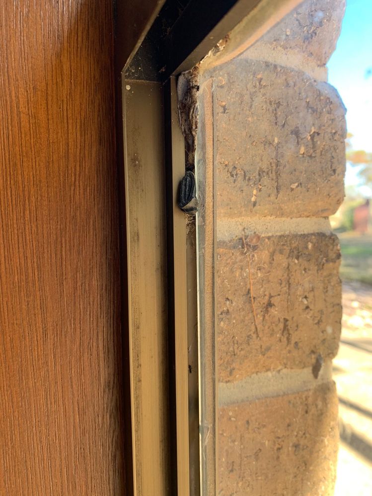

Hi all,
Seeking advice on what the black seal/edging is around window panes? One of my windows has none. Please see photos for context. Thanks so much
Hi @JSLawrence
That black rubber is used to hold the glass in place so what you need to do is get a good bit of it and take into bunnings and see if they have a close profile (shape and size ) match. Dunlop rubber also have a good selection of rubber seals for most application.
There are other foams and rubbers but ideally you need the correct one.
At a pinch glaziers should also carry it as thats there expert field they need it to fix windows but they will charge an in flated price possibly
Hi @JSLawrence,
The black rubber seals around your window are specialty glazing rubbers that are sized to match both the thickness of the glass and the cavity that it sits in.
This is a specialty product that glazier's source from glass producers and suppliers.
Unfortunately, it is something you will need to contact a glazier for assistance with.
Hi @JacobZ @Jewelleryrescue ,
Thanks for your advice on this. I have put some temporary window sealer in place until we can get a professional to do the job. Thanks again.
