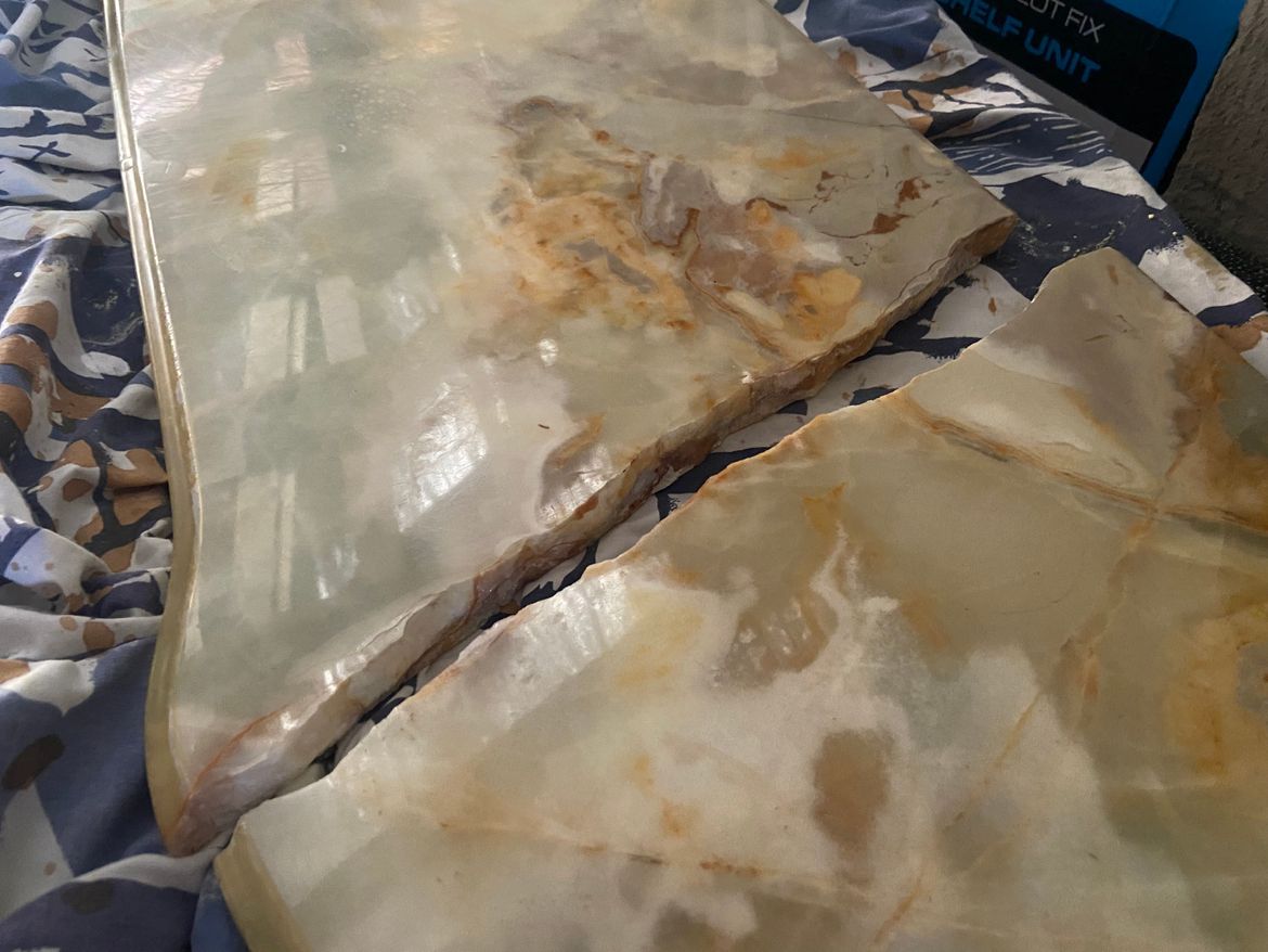

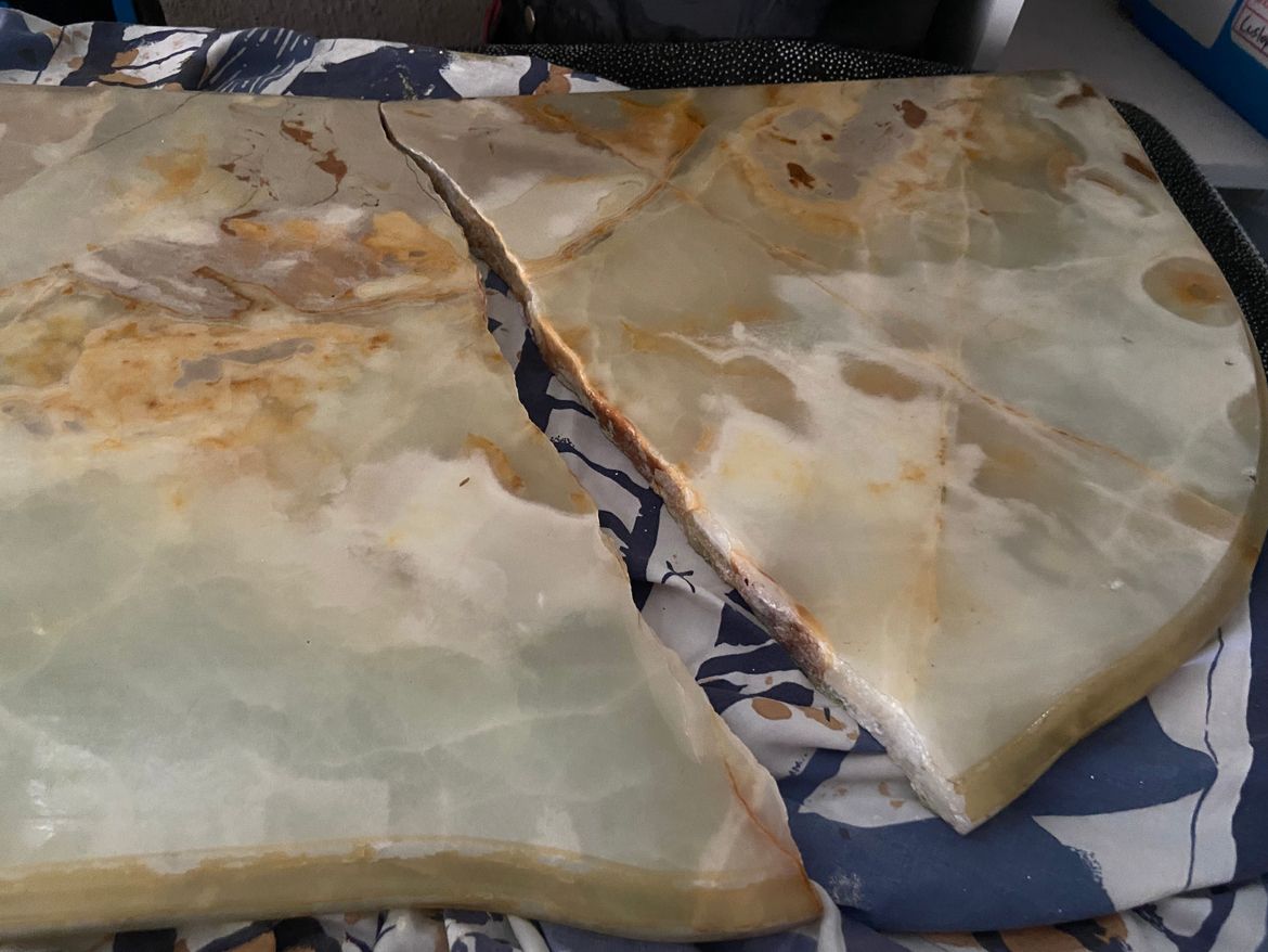

Hi Guys,
What is the best to repair the broken marble table top? Ideally something strong enough so that it doesn't need support underneath.
(It can be in any color as I will restore the surface later)
Thanks
Colin
Hi @colinweiren
Wow thats a nasty break
To Glue it i would use super strength araldite
I would use clear packing tape over the glue on top side of the table to give a flatter glue finish. underneath optional.
You will need to sand any table top glue lumps off with a sander using wet and dry sand paper 1200gt There may be hollows you will need to fill with glue and sand again until the table top looks lovely flat and polished the clear glue will blend in and the join will look like a marble natural feature
But I would recommend if possible structural supports under and across the crack line if possible
I might be tempted to glue a Ply board smaller than the marble cut to shape and use it to support both halves.
To Save money I might use super strength builders glue in the bottom half of the crack and also to glue support tubes on with and only use araldite in the top 5 mm where it needs to be clear. Use glues at the same time.
Well big job ahead if you love this table.
But doable.
Hi @colinweiren,
Thank you for your question about how to fix a broken marble slab.
As @Jewelleryrescue has already said, your best bet is an epoxy such as Selleys 200ml Araldite Super Strength Epoxy Glue.Unfortunately, I am not confident that you would be able to have the crack entirely unsupported with just glue keeping it together. You will need to consider attaching some plywood to the underside of the marble or adding some form of support.
Thanks guys @JacobZ @Jewelleryrescue . Very appreciated. I will give Selleys super Araldite a try.
I just wanted to confirm what the others have mentioned and clarify that you'll be supporting the crack structurally and not just relying on the glue. If the stone table has cracked, then the Araldite will not be enough on its own to support the weight, and given the size of the piece, it could cause significant injury when the glue fails. You'll need to support the bottom of the table with plywood or brackets.
