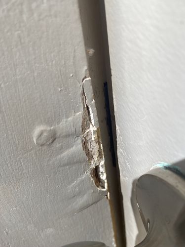

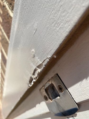

Hello,
i got a question - how do you fix the following door chipped?

That timber edge needs a sand paper block 240gt and sand the outside edges smooth and level to a straight up and down line as the timber looks like it is lumpy there,
Then use some wood filler , No more gaps or gyprock Joint compound sand easy. Into the holes why it is dry sand it again .
Then repeat process to fill any smaller holes un till the door frame is square and smooth Ready for a paint coat.
While your at it look around on closest timber work and do little patches ready for a fresh coat of paint.

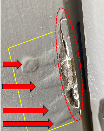

The broken away edge appears to be an already repaired area that has given way over the years. Those white chips you can see under the paint is the fill which I have highlighted within the red circle. This will all need to be removed before filling as per @MitchellMc great advice. If you have a small piece of flat timber about thats taller than the cracked area, you could tape it to the inside edge. That way when you apply the bog/filler it will give you a neat surface at least on one side to fill to. This would be removed once the big has dried. As @MitchellMc mentioned, the bog cures very hard. But this also makes it harder to sand back. Before it goes completely off, I use a chisel or metal scraper to shave off most of the excess, but still leaving it slightly raised to allow for the shrinkage.
The bubbled paint area is where water has got under. I would get this area ready before doing the edge fill. Though you can definitely sand this area out, personally I would use a sharp Stanley style knife and make a shallow cut as per the yellow lines. Then remove that section of damaged paint, which then be ready to sand as also advised. Perhaps start with a 120grit or 180grit where the paint meets the unpainted area then move on to the 240grit.
