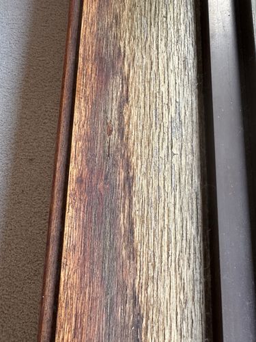

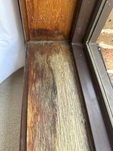

Can I use Danish Oil on these sills or are they too far gone? Some are not as dry as this but dry and stained nonetheless.
Hi @kandafino
The timber looks in good condition apart from the stain
But you will need a detailing sander to get into the corners and sand that stain out back to a uniform timber color as the oil will show up any marks
(90 grit then 240 grit will speed the sanding process up.
Or you may wish to paint over the stains an easier process,
Thanks for the reply. Should I use the dainish oil? Will that help when there is condensation in the winter as well?
