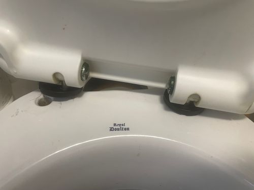

Hi, hoping someone can please point me in the direction of what I need to purchase to replace the black buffer between the seat and toilet? Toilet is Royal Doulton and seat is Haron. Thanks in advance.
Hi @fraser
Your doulton loo might be fixed with the following toilet fixing kit
It looks very close to your needs.
I would press the silver button on the inside of the loo seat to release the seat post and take the seat post/mount to bunning for a direct comparision,
The black rubber insert is replced by top inserted nylon plug these days and shuold fit your hole. Also measure you porcelin hole diameter as a test for kit compatability with the white nylon plug.
Kit easy to use and is top mounted.
Hope this suits your needs
https://www.bunnings.com.au/kinetic-toilet-seat-fixing-kit_p4920460
Legend! Thanks a bunch, I’ll do exactly this.
