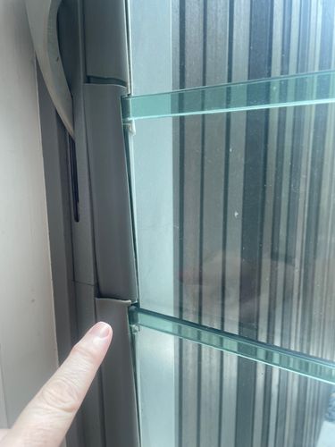

I have Altair window Lourves and one pane is out alignment preventing a perfect , secure seal.
any tips on how I can realign it?

As these windows are very mechanical in nature offer a little lubrication will help them move properly.
Can I recommend a silicon spray can? It will have a plasitic nozzle and basically insert it down the insides of the louver handle slot and into the hinges of the individual louver pivot points. Avoid oil sprays like wd40 as they will work well for a while but gum up later with dust,
The goal is to free the mechanism to work as freely as possible.
Age can make these items sag with age It maybe possible the makers of this quality product can provide you with a spare parts kit or service to restore them to optimal performance.

If you're having trouble with the alignment of a louvre pane and can't see any mechanical reason why the window isn't shutting properly, it’s a good idea to first inspect the window for any obvious issues such as bent or broken parts, or something obstructing the mechanism. However, if everything appears intact and there’s still an issue with alignment, the best course of action would be to reach out to the manufacturer of your Altair louvre window. They would have the most specific and detailed knowledge about how their product works and can provide troubleshooting advice or even recommend the right tools or techniques to realign the pane effectively.
It's possible that there could be a minor adjustment needed in the system, or there might be a unique method for realigning the panes that only they would be aware of. Contacting the manufacturer will ensure you’re following the correct steps to avoid any damage to the window or its components.Please let me know if you have any questions.Mitchell
