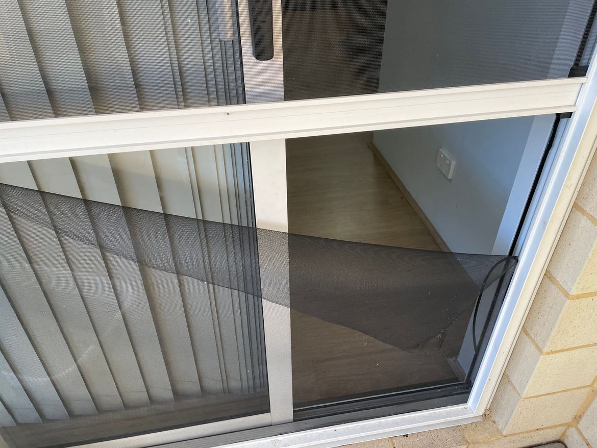

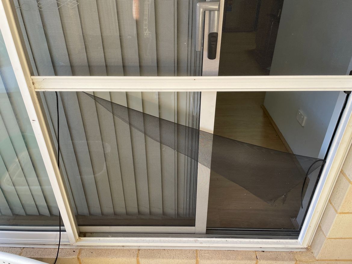

how can I remove the frame or no need to remove the steel frame
Most sliding frames can be removed by lifting them up and pulling out the bottom edge from the track in one motion. It will be much easier to replace the mesh if you pull the frame out to be able to lay it down flat.
