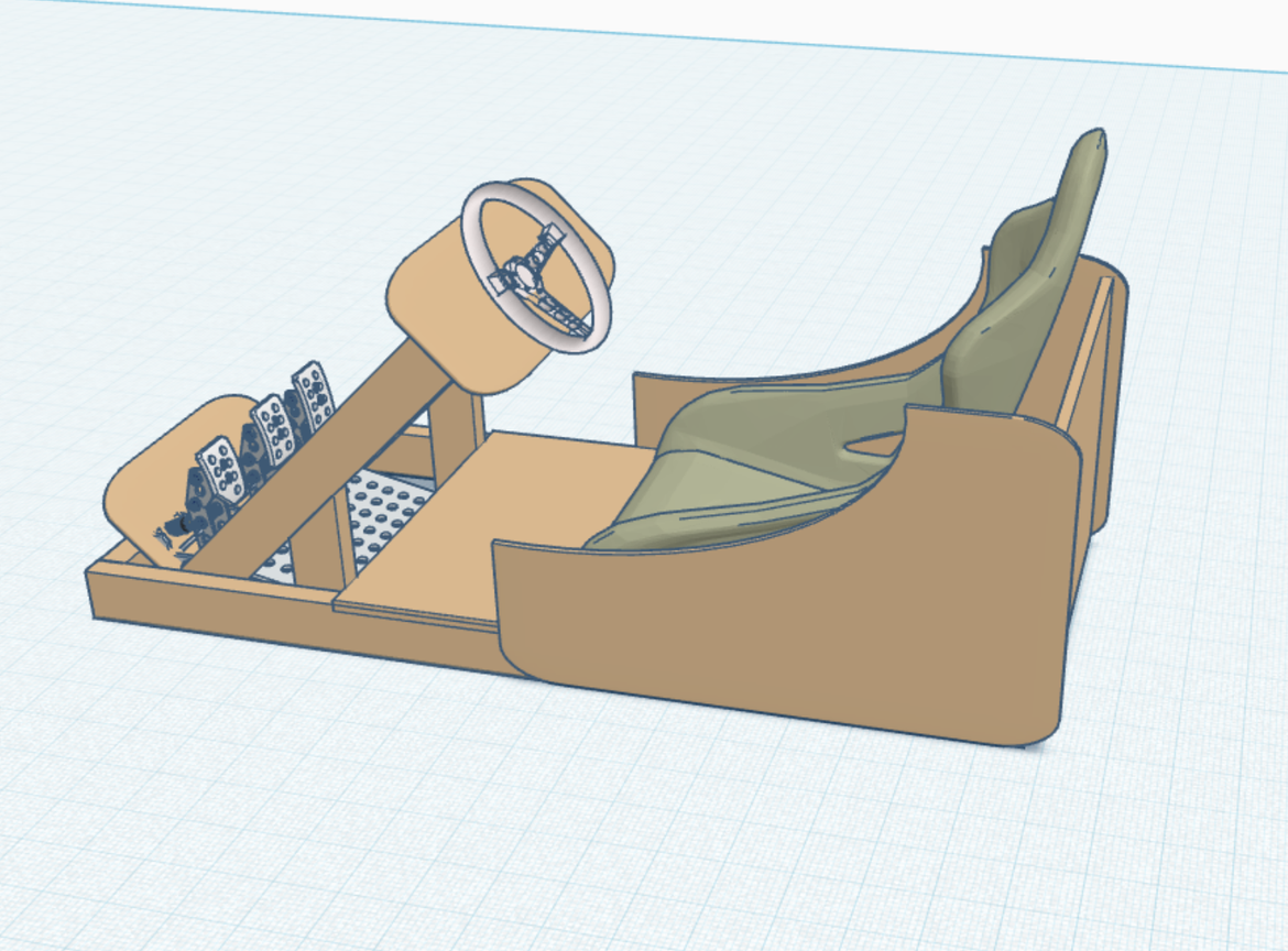

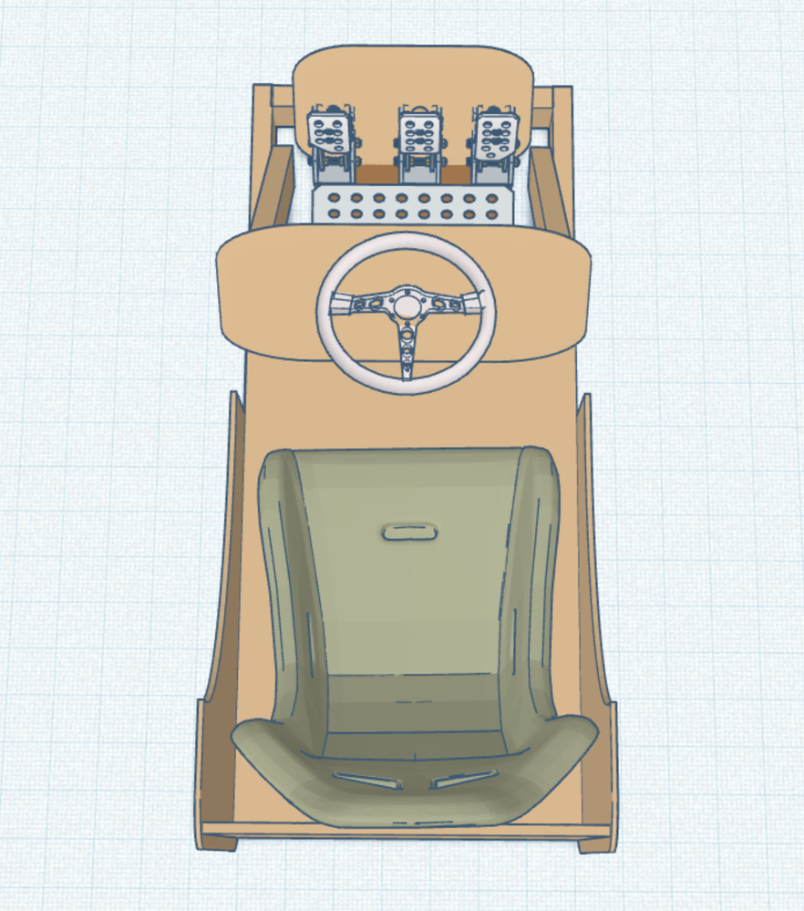

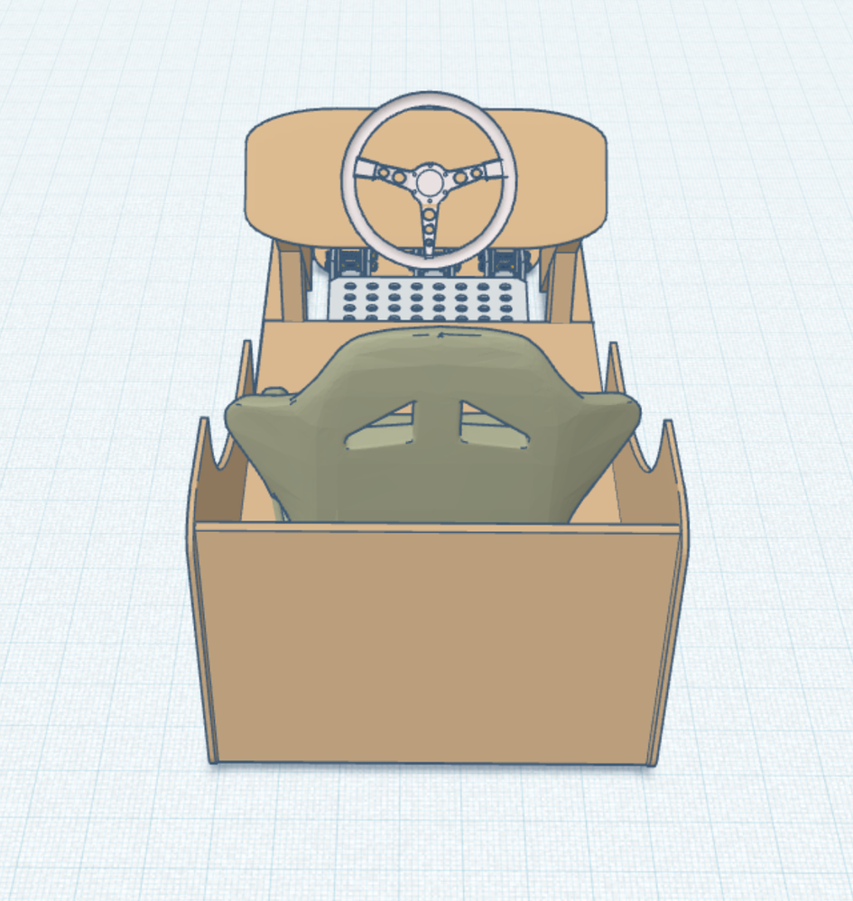

Welcome to the Bunnings Workshop community @bobby223. It's amazing to have you join us, and many thanks for your question about building a racing rig.That sounds like a fantastic project, and I'd definitely encourage you to check out other DIY sim racing rigs that people have created. There are tons of resources and inspiration online that could help you figure out the best design for your needs.
Start by sketching out a plan for your rig design—think about the dimensions, the placement of the steering wheel, pedals, and chair, and how to secure everything in place. Having a clear vision from the start will make the build process a lot smoother.
While $40 is a tight budget, I think you might need to expand it slightly to ensure you have the necessary materials and tools. With a budget of under $100, you should be able to get all the components you need. I’ve created some renders below to help you visualise a basic, compact sim racing rig using 2x4s. You can modify these designs based on the specifics of your Logitech Momo Racing wheel and the chair you plan to use.Please let me know if you have any questions.Mitchell
