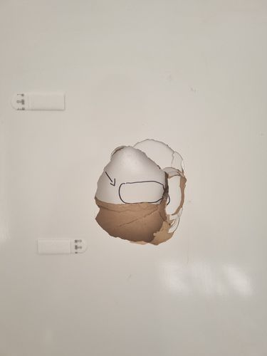

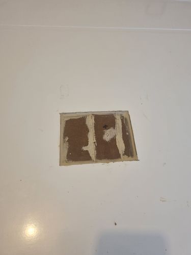

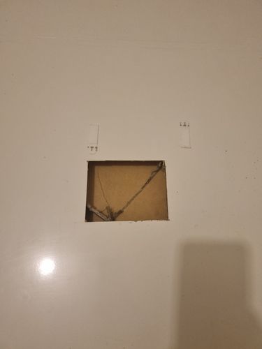

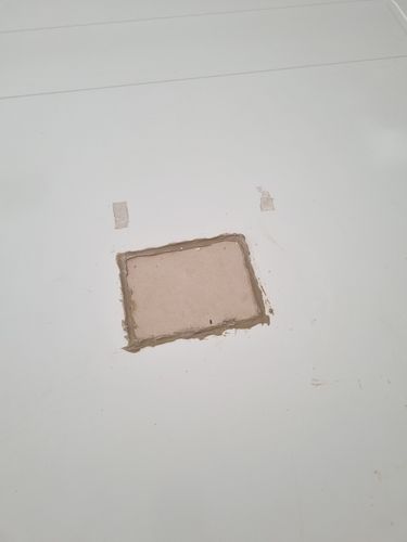

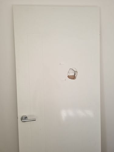

Recently purchased a house with this less- than-discrete cover up for what I presume (hope) is some teenage boy testosterone gone wrong.
If anyone has a better repair idea than mine for this it would be appreciated.
My idea is to:
- cut around the area to create an even square
- glue a backing board behind the hole (cut into two so it fits the hole)
- glue a square of board equal to the depth of the door's board onto the backing board
- fill the gap with a flexible filter (maybe no more gaps?)
- sand and paint
Happy to be told I'm going about this all wrong!
