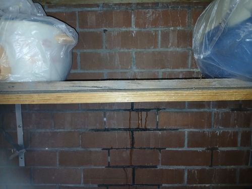

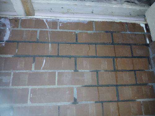

After the heavy rains we had in Melbourne several days ago (the one that lasted hours), I noticed water seeping through the garage brick wall (single brick wall). From what I can see, it's not water coming from the top because some of the mortar above is dry. Rather it seems to have come in through the mortar.

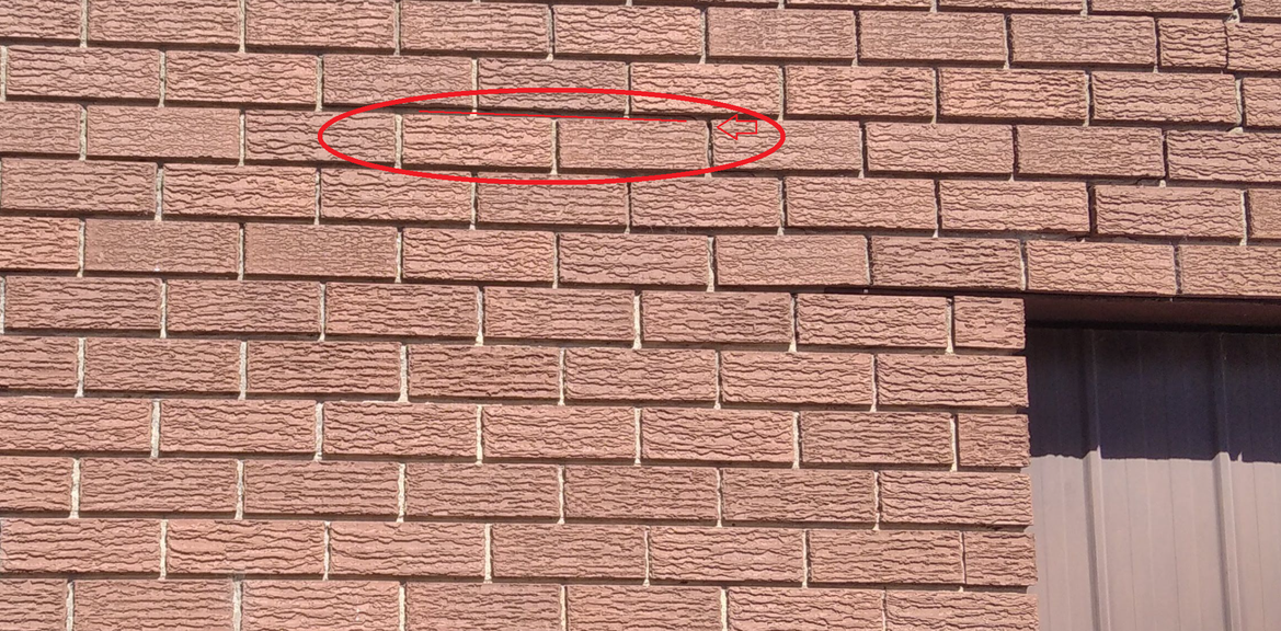

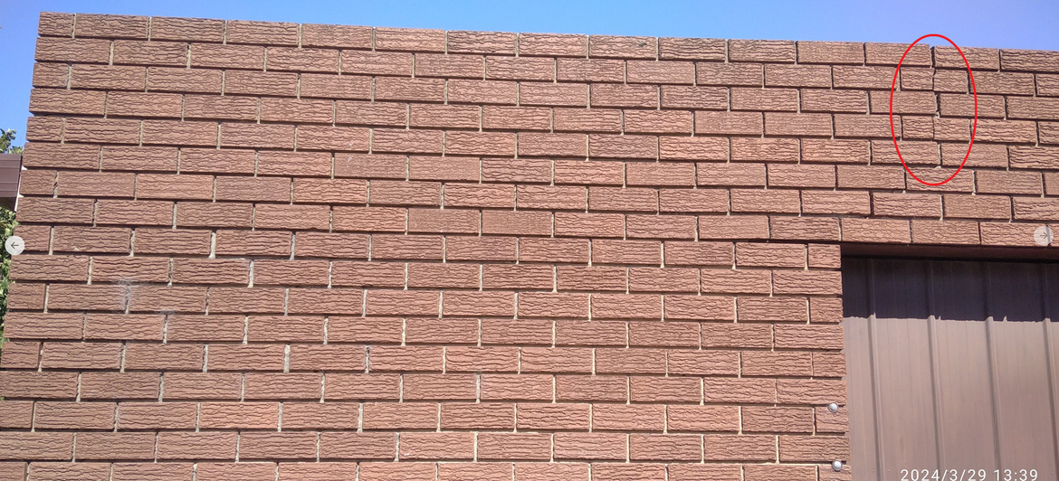

(I am a bit puzzled why it has not happened before though). I inspected the outside and saw some holes in the mortar. Maybe that's how water seeps through. I will first fill them in with Mortafill or mortar and observe.

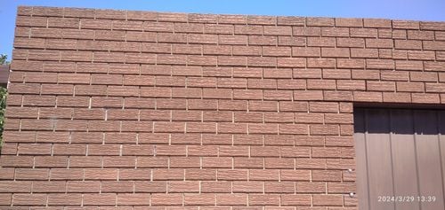

Included is a photo of what the bricks look like outside.
