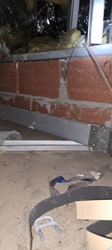

Hi all. Long time reader first time poster, bit stumped in my latest project, I want to fit two doors to an open living room. House is double brick, internal walls single. I planned to use Ramset plugs and long crews however have found out the brick work is laid internal cavities facing the door way so I just drill into nothing. Next option is chemset. pump the cavity full and apply construction adhesive to the flats. Apologies if it's not clear hopefully the photos will help. Second one is in the ceiling above the door way.
