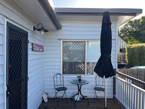

Hello @Timothy1967
There are a few ways for you to build cover for your patio. First, the patio frame can be self-standing which means that technically the patio structure is not anchored onto the frame of the house. Next is attaching the patio structure to the rafter of the house and basically creating a roof extension over the area. The final method is to attach a Roof Extenda MKII Bracket With Black Weather Seal Package on the frame of your roof.
Before you begin, I suggest visiting your local council and having a look at the rules and regulations regarding building a patio cover. I suggest engaging the services of a draftsperson to draw up a plan for your patio roof frame. They will be familiar with the rules and regulations of the local council which will allow you to submit your plans with relative ease. A permit might be necessary, it all depends on the rules of the council.
If the plan calls for anchoring to your existing roof frame, you'll need to engage the services of a registered builder as it will be an involved and complex build.
let me call on our experienced members @Dave-1 and @Nailbag for their recommendations.
Morning @Timothy1967
You would certainly have a nice patio then, but first step would be to contact or view your local councils website. They should have a set of rules regarding patios for your area. Covered patios definently should be mentioned. Also the height from your deck/door height and where it would be attached would be something to think about. @EricL's suggestion of a roof extender bracket would be how I would go as well. Just to give it height.
With lift and strong winds, that is something else to consider with a solid roof. I would probarly do some sketches of what you would like it to look like, where you would place supports. Taking into account your windows and doors. This would give you a good place to start talking to a draftsman or builder. Having it built professionaly will lower any insurance issues down the track if there is an issue.
Hi @Timothy1967
There are a few ways you could build this. All will impact the existing balustrade in some way. As both @EricL @ @Dave-1 suggested, I would definitely get a local draftsperson in to discuss the options with you. From there they can also provide the plans you will need to submit to council for the building permit. Once thats approved, you can get about building it.
Not to deter you, just bear in mind that this project wouldn't be one suitable for a beginner and will require quite a few different skills and power tools. You will also need a plumber to connect up the guttering should you decide to install this yourself.
